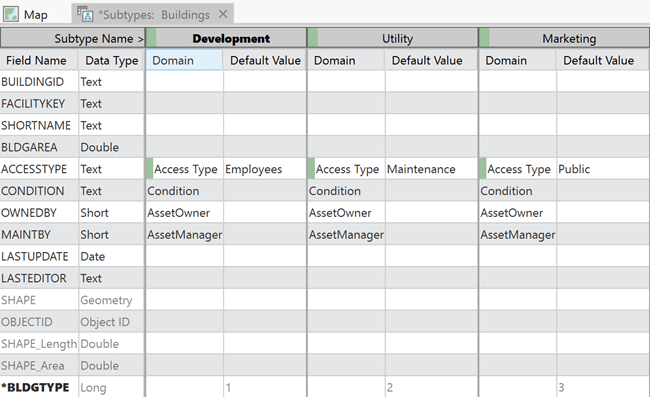

SAMIRMOURAD
Let's say that in the exemple below, In Utility Access Type, I would like to remove the link to Domain.
I want to empty the the default value and the domain for AcessType in Utility. I know that I can do it directly on this table, but is there a way of doing it using a pyhton script ?
Thanks

JackvanderHorst
https://pro.arcgis.com/en/pro-app/latest/tool-reference/data-management/remove-domain-from-field.htm
arcpy.management.RemoveDomainFromField(in_table, field_name, {subtype_code})
NameExplanationData Type
in_table
The input table containing the attribute domain that will be removed.
Table View
field_name
The field that will no longer be associated with an attribute domain.
Field
subtype_code
[subtype_code,...]
(Optional)
The subtype code(s) that will no longer be associated with an attribute domain.
String
Example:
    in_table=r"xyz.gdb\UtilityNetwork\ElectricDevice",
    field_name="ASSETTYPE",
    subtype_code="'50: Armatuur'"
