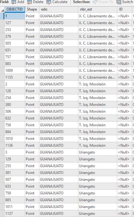

I made a table with transposed fields where 1 record from my original table became into 10 records on the new table with the transposed fields. So I want to give to my 10 new records an ID in a new field according to the name field.
I'm doing all of this on ArcGIS Pro 2.3.3, inside of the attributes table.
I attached an image.
I want every 10 records with the same nbr_est to have the same ID in a new field. There's a lot of records and that's why I don't wanna do it with queries and the simple field calculator.
I'm sorry, I hope I have explained my self way better. Thank you so so much.

Thank you, I understand now what you are attempting.  Couple of additional questions;
1) can you include the ID in your original table before your transpose the additional records.
2) are you attempting to only assign an ID based upon ndr_est, correct?  or will it also be dependent upon edo as well?
3) do you have another table with the wanted ID and ndr_est values available?  If so, you can perform a temporary attribute Join in ArcGIS using the ndr_est values and use field calculator to copy the ID values from one table to another then remove the join.  Please see Overview of joins and relates—ArcGIS Pro | ArcGIS Desktop.
4) are you comfortable with python scripts?  If so, you can use something along the lines of the following:
