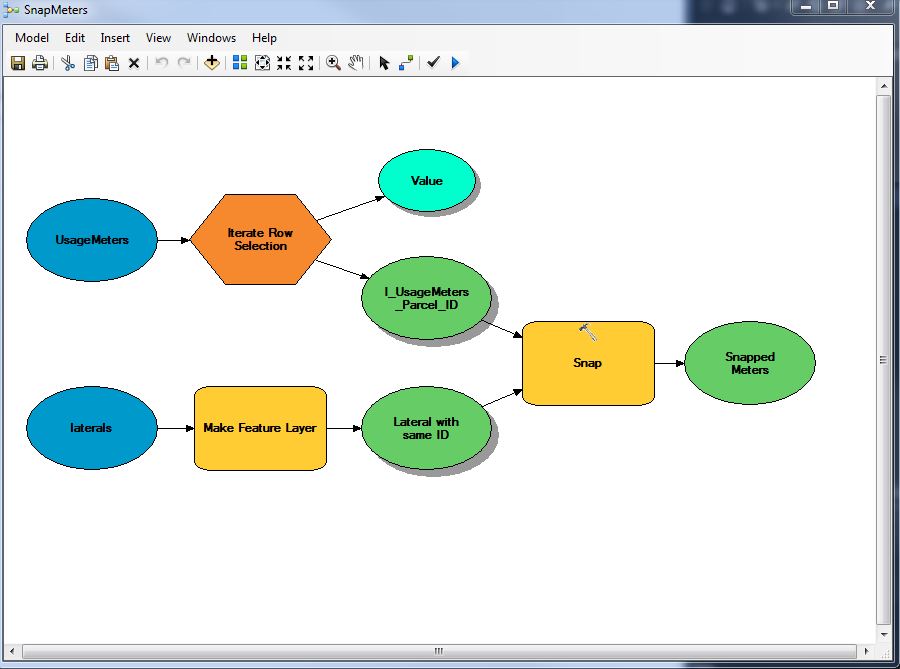

I suspect you are correct, however, I am not sure that you can delete a feature layer seeing as how it is just a reference to a feature class as opposed to a physical copy. I attached an image of what I have to give you an idea of what's going on.

In modelbuilder, I don't know, I suppose the defn query is made somewhere in there and access to it in modelbuilder might not be possible.  a copy of the exported script might help, just make sure your model parameters are in the correct order before saving... unless someone that uses MB alot has some idea how memory is managed in that enironment.
