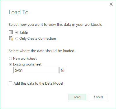

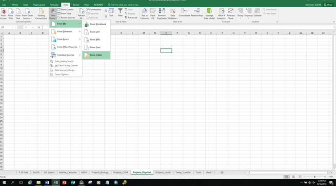

GailMorrison
This might be easier to do in Excel:  I can't give you all the steps as they have govt. pathnames within the screen scratches.  When you click on From Folder, a gui opens to allow you to Browse to a folder path, then click OK.  Once a directory list is created, you can move the columns around. Using the Extension down'arrow, you can sort for just *gdb, *shp, etc.  Last, Close & Load To ... (an excel worksheet).  It's very fast & easy to use.
www.youtube.com/watch?v=GO-Q8j2lW2s
Get a List of File Names from Folders & Sub-folders in Excel (using Power Query) - YouTube
Last step:
