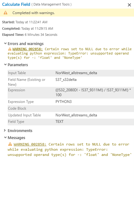

Hi, I'm trying to find the percent change of temperature using two climate projections with the formula %change=((new-old)/old)*100. When running it through "calculate field" this is what I have:
and I get this warning message with all of my values returned as null:
Any ideas?

It is a warning... one of your two fields has a null value in it, so when it tries to perform the numerator operation, it is either getting
a number - None
or
None - a number
So you will have to fix your data if you aren't expecting nulls in those fields, or you will have to fix the expression to deal with nulls.
In any event, a warning probably didn't make all the calculations fail did it?

RyanBohan
Python treats null values as none.  And python can't add to nothing.
Attribute1 = null
Attribute2 =   5
Current State:
Attribute1 + Attribute1 =
     none     +         5         = null
To handle Nulls:
Use or include a default value
(!Attribute1! or 0) + (!Attribute2! or 0) =
               0               +                5               =  5
Or use arcade:
$feature.Attribute1 + $feature.Attribute2 =
            null                 +                 5                 =  5
bcgeogirl1
This is how I fixed this problem when I had it.
%change=(((new or 0)-(old or 0))/(old or 0))*100
it puts in a 0 where the values are null. Hope it helps you
