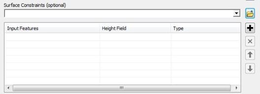

I am trying to create a python toolbox that allows the user to enter LiDAR surface constraints. The surface constraints input can consist of many feature classes with each feature class having a drop down list that lets the user select a field (z index/elevation) that is associated with the feature class and a second drop down that lets the user select the surface constraint type.

In the updateParameters() class I think I need to update the param1.filters[1].list or add append a filter to each individual surface constraint feature class. The closest I have come so far is to append all the fields to one filter.
I have attached a screenshot of the toolbox input that is from the Create LAS Dataset that is native to ArcGIS for Desktop. I am trying to recreate a portion of that that will link up with the rest of my python script.
Example Toolbox Input
Hopefully that explains my predicament.
