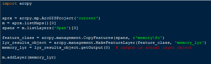

I think I found the solution, at least for 3.0.2.
You have to make a feature layer, and then use the .getOutput() method on the results object to get the actual layer object. That can be added to a map. You still need to run the script from a toolbox inside of the map, since it's in memory, a standalone python script will add the layer to the map, but the connection to the data source will be broken.

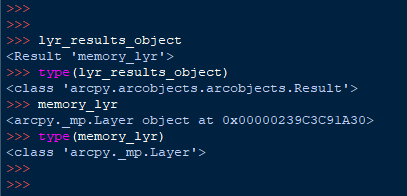

If you look at the datatypes in the second screenshot you can see why it works.

@Anonymous User I can confirm this works. Thanks a lot and happy holidays when you get there!
