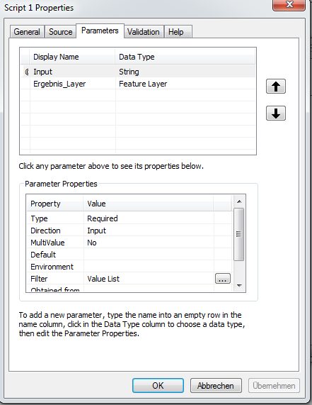

Parameters for the script are defined as follows:
If I integrate my script in the Modul Builder in ArcGIS, this script stays white.

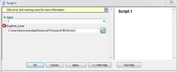

I want to generate the Result_Layer(Ergebins_Layer) as Output. The routine shall then work with the output. Right now, the entry mask of the script queries the Result_Layer(Ergebins_Layer). The output file is not yet generated. I can’t put something in the mask, that is not there. It looks like this:
How can I adjust the code, so that the Result_Layer is only generated as the output?

if you are providing a 'value list' as the input string what is your output parameter defined as? Is it 'derived' from that?
There is nothing showing in the first line currently and is your output parameter derived?
If the output is derived it shouldn't show in the dialog
If your script tool has derived output, you need to set the value of the derived output parameter in your script using the SetParameterAsText or SetParameter function.

At the moment the output Layer is defined as Feature Layer. When I set the output as string the script turns yellow now. But the output is empty. What do you mean with “There is nothing showing in the first line?”

Your input line.  A feature class (unless you want a *.lyr) might be more appropriate for your output
A derived parameter wouldn't have the 2nd line, because derived parameters are output
