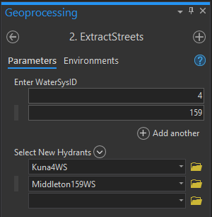

This is the code that I have so far, and it works great when I enter in one WaterSysID number.  However, I'd like to be able to enter in multiple WaterSysIDs and generate a road network from those.  Like what's shown in the screenshot.
However when I do this I am then given this error:

So, what's happening is that you aren't telling it what to do if you have more than one input.
That is, it's expecting one value (In your example, "4"), and it's getting "4;152" as a string, which I assume is not a value in your dataset.
You should convert it to a list, then iterate whatever you're doing over the list.

Your where clause will need to updated to select the multiple SysId's as a set as well, after they are split into a list.  This can be done by using SQL's IN and some join formatting.
