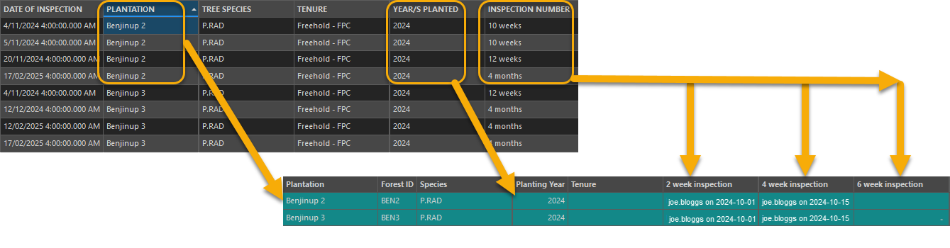

Here's what I'm trying to do. I have a feature service (FS1) which contains inspections. These inspections can be identified by values in the following fields: plantation, years_planted, date_of_inspection & inspection_number.
Feature service 2 (FS2) contains 1 row per plantation and planting year (e.g. Ferndale:2024, Ferndale:2025, etc.) and a number of fields to record if an inspection has been completed or not based on a regular cycle.
Below is a list of values from FS1's inspection_number field and their corresponding field name from FS2.
'2 weeks': 'insp_2_weeks'
'4 weeks': 'insp_4_weeks'
'6 weeks': 'insp_6_weeks'
'8 weeks': 'insp_8_weeks'
When an inspection is done in FS1, the corresponding row in FS2 should be updated to record that it has happened by updating the corresponding inspection_number field with "username on inspection_date".
Below is the code I have so far. I know it works up to Line 80 based on print statements returned. I can't seem to get it to match up the features from FS1 (lots of inspections) with FS2 (inspection tracking) though, and once matched, update the corresponding inspection_number field.

 I feel like maybe this would be better done using arcpy.da.searchcursor or something like that, but I'm not proficient in wielding that code yet.
Visual representation of the data below (the dates don't align, but you should get the idea). Repeated inspections should trigger updates to a series of fields in a row.
