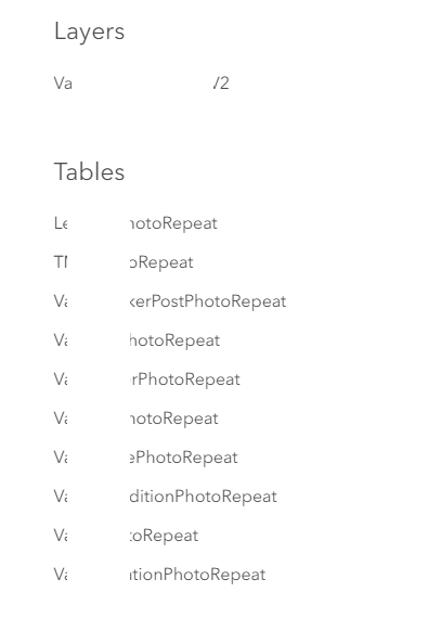

i'm trying to clone a Survey from one org to another, ive tried the guides here:
Clone surveys from one organization to another | ArcGIS Survey123
Survey123-tools/Clone_Surveys at main · Esri/Survey123-tools · GitHub
but it never actually copies the survey
i have also tried the "ArcGIS Assistant "
the survey isnt that complicated its a point feature layer and 10 related tables, each has no more than 10,000 records (most have 1000 to 5000) including attachments
has anyone managed to clone their survey?
