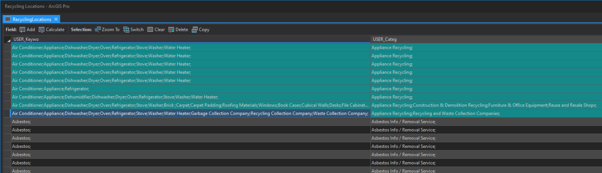

Thanks for the reply. The whole table has 600+ records. Here's a screenshot of both fields.
To reiterate, is there a pythonic way to group these features like so, for example?
