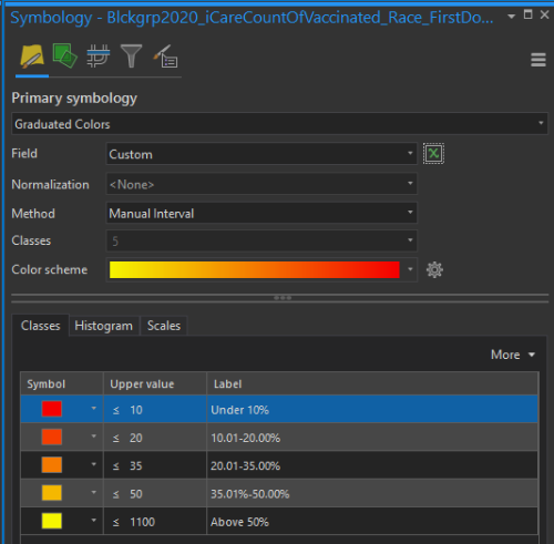

I have this small code to change a feature layer's symbology. I'm referencing this help doc.

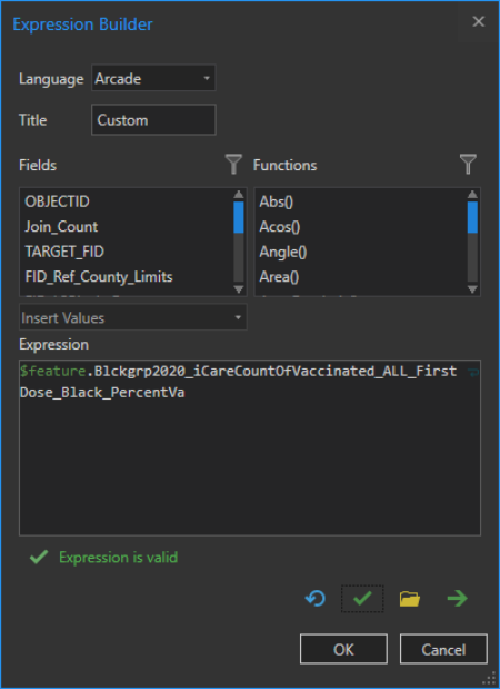

When I try to change the break count I get a RuntimeError. And when I try to identify the classification field I don't seem to find it. Using a print statement, I identify other properties but not the field. The only thing i can think of is possibly because this field is set to a custom expression:

Looking into this further, i realized this classification field I'm trying to identify is a from a joined table. If I use a field not from the joined table it works fine.
The 'USER_PATIENT_ZIP' field is not from a joined table, and it validates. But, the field I want is from a joined table, and it's invalid somehow.
