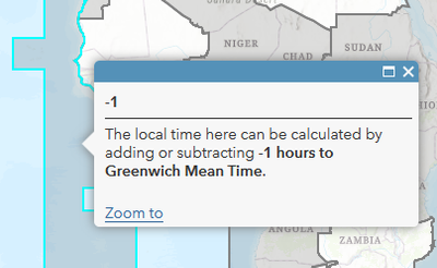

To calculate the "local time" of prior submissions, you'll probably need to add a new field and calculate its values. You could do this easily enough by spatially intersecting your points with the World Time Zones layer and using the Zone field.
