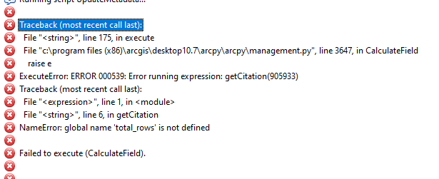

I am trying to call the global value 'total_rows' inside the expression. But I am getting an error.
and my code is
def execute(self, parameters, messages):
"""The source code of the tool."""
   inputdataset = parameters[0].valueAsText #getting the parameters
   count_rows = arcpy.GetCount_management(inputdataset)
   total_rows = int(count_rows.getOutput(0))
expression = '''
   def getCitation(p_dataset_id):
      global total_rows
      if(total_rows == 5):
            ds=PanDataSet(p_dataset_id)
   return ds.citation

AarthiBalamurugan1
Inside the expression the global value is not working. I want to get the number of row values inside the expression.

AarthiBalamurugan1
No It didn't work as well. I am getting the same error. If it is outside the expression it works.
Right now I am just testing the code whether the global values can be assigned inside the expression.
I am sending the dataset id value to the server to collect the data. Within 30 seconds the server can handle 60 data if it is more than that it stops working.
So I want to get the total number of rows and if it's more than 60 rows I want to delay the processing.

It's a string expression and is evaluated outside the scope of your current code so has no knowledge about any of your variables.
You need to insert the actual value into the string:
class YourTool(object):
    def __init__(self):
        etc...
    def getParameterInfo(self):
        etc...
        inputdataset = parameters[0].valueAsText  # getting the parameters
        expression = '''
  total_rows = {}
      return ds.citation
'''.format(total_rows)
Note - you can't indent the expression, or it won't be valid python syntax when the tool evaluates it - IndentationError: unexpected indent.  If you want your code to look cleaner and have the expression indented, you can use inspect.cleandoc(expression)
