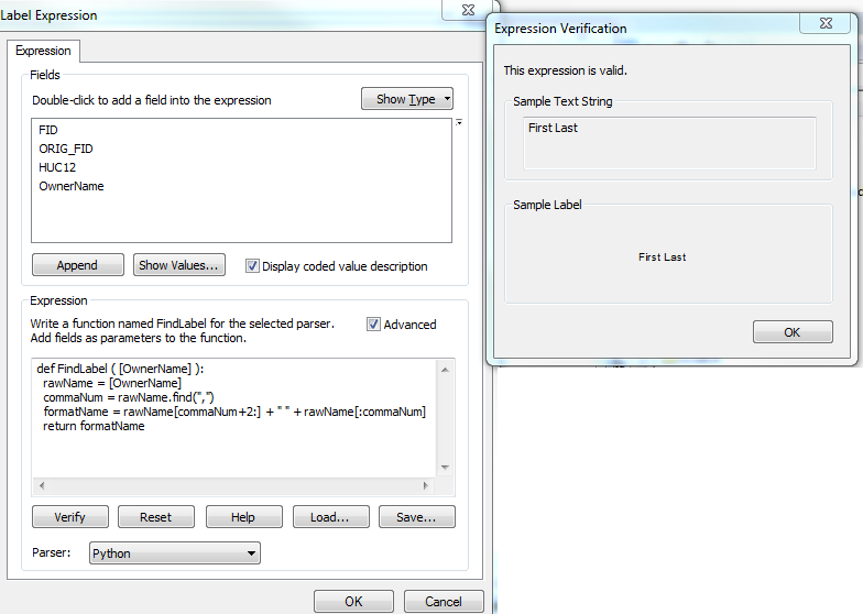

Your first set of code worked for me, I just copied and pasted what you had. Just be sure you have advanced checked and your parser is set to Python.
Jeremiah_OlatundeGbolagun
Deactivated User
No I do not think so. This code was copied from the GIS tutorial for Python
Scripting tutorial 1 example. Please note that the code is to be run ArcGIS
10.2. But I ran the code on ArcGIS 10.1 and it gave me error that I sent to
the GeoNet forum site.
curtvprice
MVP Alum
Pretty strange, sir, your code works for me (10.1 SP 1).
I agree with the advice above to click the advanced checkbox and set the parser to Python before pasting the code.

Hi David,
Thank you for responding to the Python error I posted on the Geonet forum.
Please note that the code written in your book worked well when I rerun it.
But I later discovered the cause of the error which was due to
inappropriate use of the code indentation. For example, if you do not use
the appropriate number of spaces as you have written in the book it will
result into error. if you checked the error that I posted you will
understand what I meant.
Regards,
Jeremiah.
