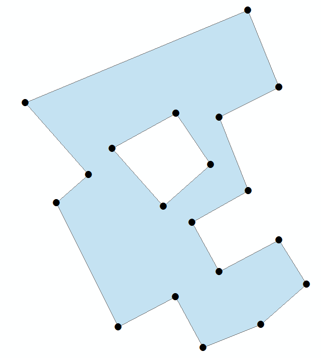

Hi, i am trying to write a code in python that will get me all the vertices from one polygon object. Normally that wouldn't be a problem, but this object comes from Geoview 6, and this polygon object has a hole in the center. In ArcGis 10.2, when you load polygon object, it looks normal. Sketch properties shows all vertices. But when i write a code to print vertices, or to get them in any way, it returns only the outer vertices. It doesn't show (print) 4 vertices inside. Can someone help, and write a code that will print all 19 vertices that this polygon has?
Most importantly, do not change the polygon in any way. When you modify the polygon and save changes, it works. But when i have 1000 polygons, i don't have time to modify them all.

But, if I access the JSON property of the polygon I do see the two rings:
def main():
    import arcpy
    import json
    fc = r"D:\Xander\GeoNet\Vertices\Sample.shp"
    with arcpy.da.SearchCursor(fc, ("SHAPE@")) as curs:
        for row in curs:
            polygon = row[0]
            jsn = polygon.JSON
            dct = json.loads(jsn)
            rings = dct["rings"]
            rng_cnt = 0
            for r in rings:
                rng_cnt += 1
                print "ring: {0}".format(rng_cnt)
                p_cnt = 0
                for p in r:
                    p_cnt += 1
                    print " - pnt: {0}, {1}".format(p_cnt, p)
if __name__ == '__main__':
    main()
... it lists the two rings and all the points:
ring: 1
 - pnt: 1, [572289.7662000004, 4796863.0558, 198.3188999999984, 0]
 - pnt: 2, [572283.2280000001, 4796859.4516, 197.790599999993, 0]
 - pnt: 3, [572288.4415999996, 4796853.5474, 199.08299999999872, 0]
 - pnt: 4, [572293.2719, 4796857.818700001, 199.1073000000033, 0]
 - pnt: 5, [572289.7662000004, 4796863.0558, 198.3188999999984, 0]
ring: 2
 - pnt: 1, [572300.2334000003, 4796865.724099999, 196.37119999999413, 0]
 - pnt: 2, [572294.1432999996, 4796862.647600001, 196.47729999999865, 0]
 - pnt: 3, [572297.1459999997, 4796855.1305, 196.99559999999474, 0]
 - pnt: 4, [572291.4095000001, 4796851.9344999995, 196.8024000000005, 0]
 - pnt: 5, [572294.1533000004, 4796846.876700001, 195.8027000000002, 0]
 - pnt: 6, [572300.2434, 4796850.1324000005, 195.47759999999835, 0]
 - pnt: 7, [572303.0767999999, 4796845.612199999, 195.52629999999772, 0]
 - pnt: 8, [572298.3958999999, 4796841.520199999, 191.43429999999353, 0]
 - pnt: 9, [572292.5199999996, 4796839.1306, 195.59949999999662, 0]
 - pnt: 10, [572289.6964999996, 4796844.3179, 198.89949999999953, 0]
 - pnt: 11, [572283.8255000003, 4796841.2414, 197.29829999999492, 0]
 - pnt: 12, [572277.5213000001, 4796853.925799999, 196.55049999999756, 0]
 - pnt: 13, [572280.8426999999, 4796856.7733, 198.6637999999948, 0]
 - pnt: 14, [572274.3591999998, 4796864.141000001, 196.664300000004, 0]
 - pnt: 15, [572297.1012000004, 4796873.5896000005, 196.25789999999688, 0]
 - pnt: 16, [572300.2334000003, 4796865.724099999, 196.37119999999413, 0]
