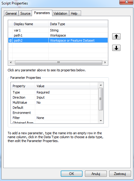

DanPatterson
MVP Esteemed Contributor
What type of script tool?  Did you define the parameters and their type using the script tool dialog after adding it to your toolbox?

MichałKozłowski
Well... just simple script tool in my custom toolbox. And yes, I defined those parameters. You can take a look:
