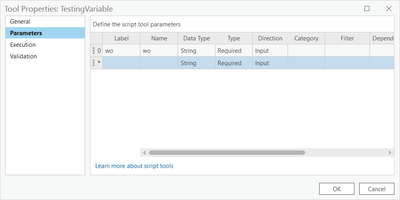

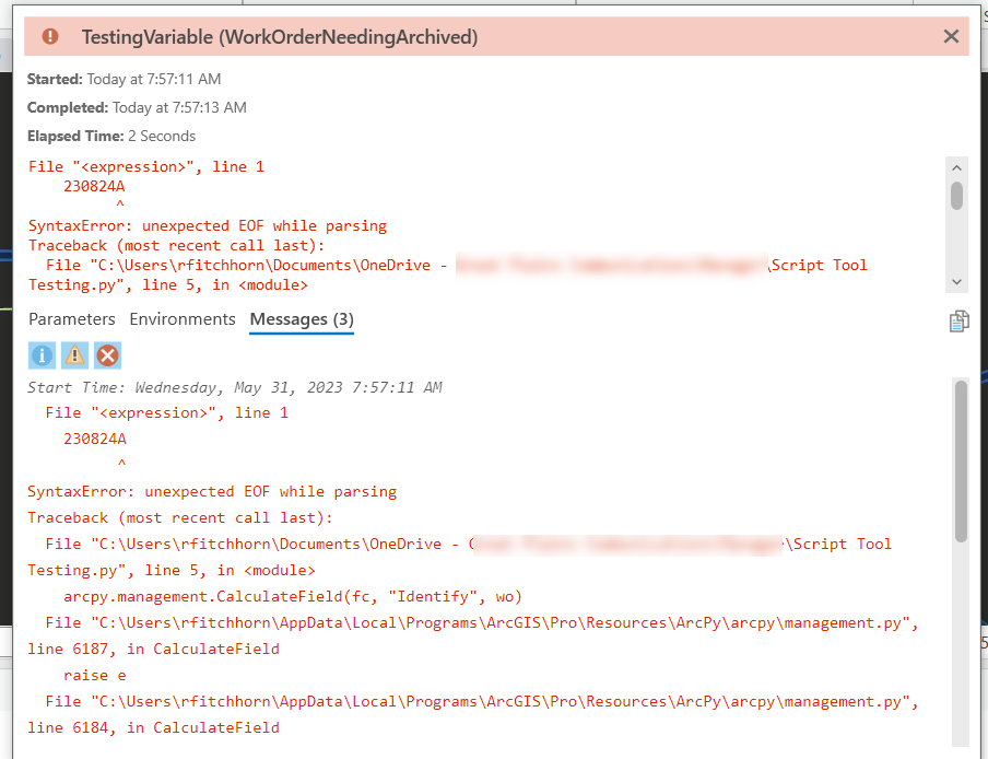

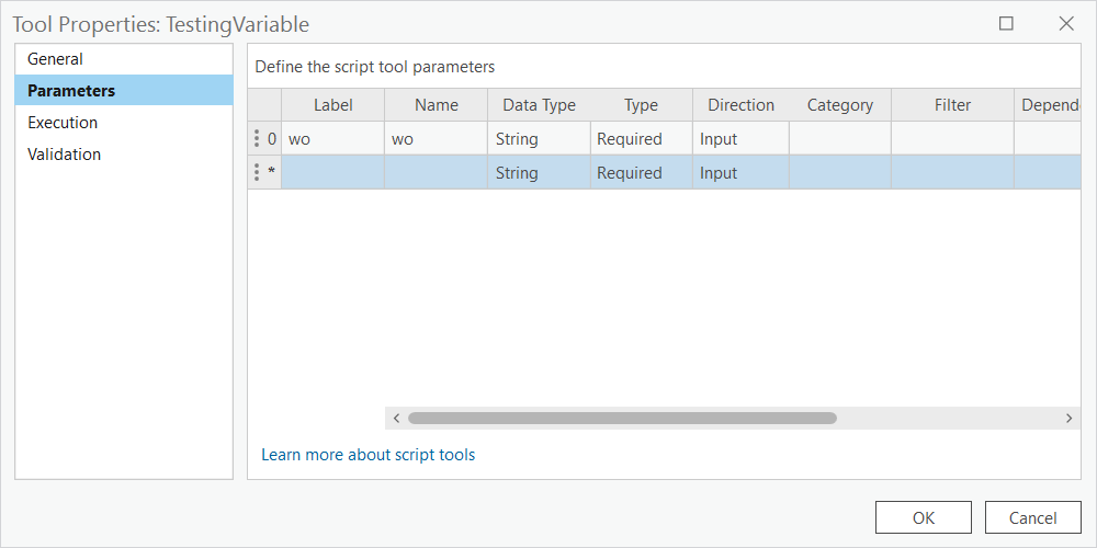

Can't get passed this one for some reason. I am using ArcGIS Pro 3.1.2 and using to NotePad++. I am trying to use GetParameter or GetParameterAsText to pass an alphanumeric value and it just won't go. I have tried to pass as a String and Any Value and continue to get the same error.

Since its alphanumeric, it should be a string, so it should be arcpy.GetParameterAsText(0)
The wo variable is being passed to the Calculate field method in the expression spot, so it needs to be an expression in sql form.  What do you want to do with the 230824A being passed in?
