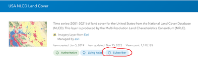

I made some progress on this in that I believe the problem is that that particular image service requires "subscriber" status which I think simply means the user has to be logged in so a token gets sent along with the request. When I log out of ArcGIS Pro and run the tool it fails that same way as when it is run on the server. I'm still at a loss as to how to do this login on the server where the geoprocessing task is running.  I did add a call to SignInToPortal call but that did not fix the problem.
