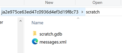

The post in here shows it should be my arcgisjobs dir right?
I am even seeing it create the jobs dir with a scratch folder in the arcgisjobs folder and even a scratch GDB but it does not use it.  I can find no way in script to find this jobs dir either.
Why is it not using arcgisjobs as configured both in the GP tool and in the server settings?
