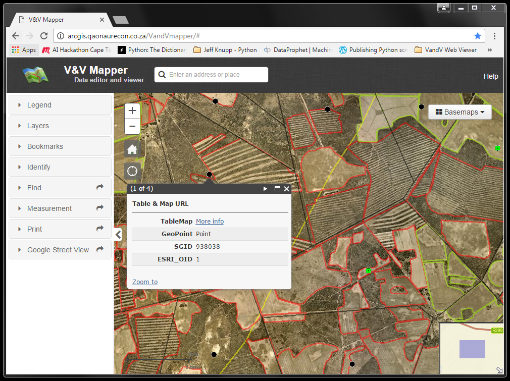

I need some advice and direction from the ESRI community. We have made use of the CMV Viewer for a project that we are involved in:
Each point refers to the landowners letter and map indicating the irrigated and non irrigated fields on a land parcel (farm portion)

What I need to do is convert my python script that it generates the output jpeg (map) using the rest services within the viewer and not accessing the data from the SDE SQL Geodatabase. The Geoprocessing service needs to use as input argument the land parcel ID and the output jpeg needs to be return as an HTML Url that can be consumed by the hyperlink "More Info" that triggers an SSRS (SQL Server Reporting Services) that generates the letter and needs to embed the jpeg thats returned as a Url.
The print Geoprocessing  Service almost does what I wan't , but I still need to handle the map template, and does the jpeg need to be saved to hard disk or could it be saved into memory and returned as an Url that the SSRS can use to embed into the letter.
