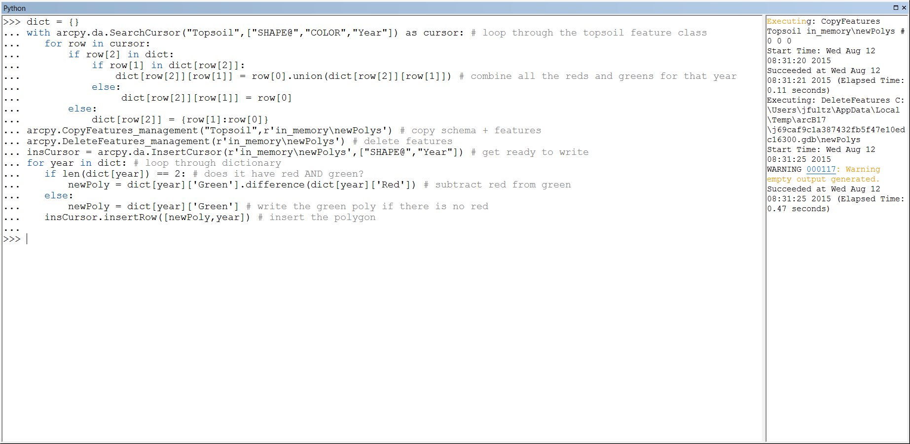

Here is an alternative way to get to your answer, using arcpy geometry objects, directly:
>>> dict = {}
... with arcpy.da.SearchCursor("Topsoil",["SHAPE@","COLOR","Year"]) as cursor: # loop through the topsoil feature class
...    for row in cursor:
...        if row[2] in dict:
...            if row[1] in dict[row[2]]:
...                dict[row[2]][row[1]] = row[0].union(dict[row[2]][row[1]]) # combine all the reds and greens for that year
...            else:
...        else:
...            dict[row[2]] = {row[1]:row[0]}
... arcpy.CopyFeatures_management("Topsoil",r'in_memory\newPolys') # copy schema + features
... arcpy.DeleteFeatures_management(r'in_memory\newPolys') # delete features
... insCursor = arcpy.da.InsertCursor(r'in_memory\newPolys',["SHAPE@","Year"]) # get ready to write
... for year in dict: # loop through dictionary
...    if len(dict[year]) == 2: # does it have red AND green?
...        newPoly = dict[year]['Green'].difference(dict[year]['Red']) # subtract red from green
...    else:
...        newPoly = dict[year]['Green'] # write the green poly if there is no red
...    insCursor.insertRow([newPoly,year]) # insert the polygon

JasonFultz
I gave this script a try but received an error stating "Empty Output Generated".   Would it have stopped because Year 00 only has a green polygon, and not a red polygon, so no clipping would be necessary for Y00?
Thanks again,
