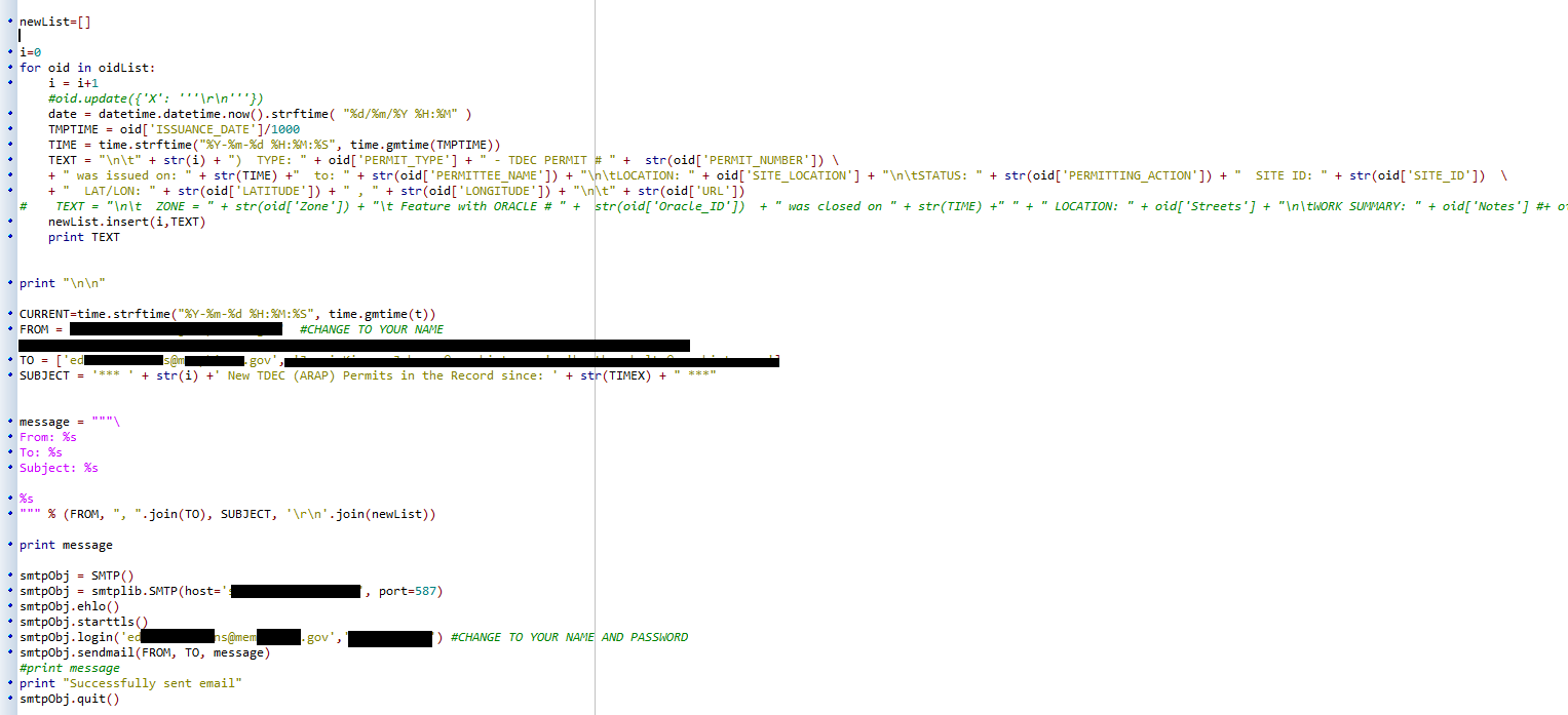

EdwardHankins
Ok so now you have built your oidList.  It should contain a list of all the OBJECTIDs and their created_date.
You can check that by typing oidList in your python window and seeing what appears.  You now have to go line by line through the list and build your email.
for me it was like this:
For you it may be different.  but think of it like this,  now you have a list (oiddict) that holds your objectid and your date.  now you open a for loop and go through each line and make your email message (TEXT in my case)  by appending it to a new list (in my case its called newList)
Then format an email msg,  and then append the newList to it.  then fire off the email.

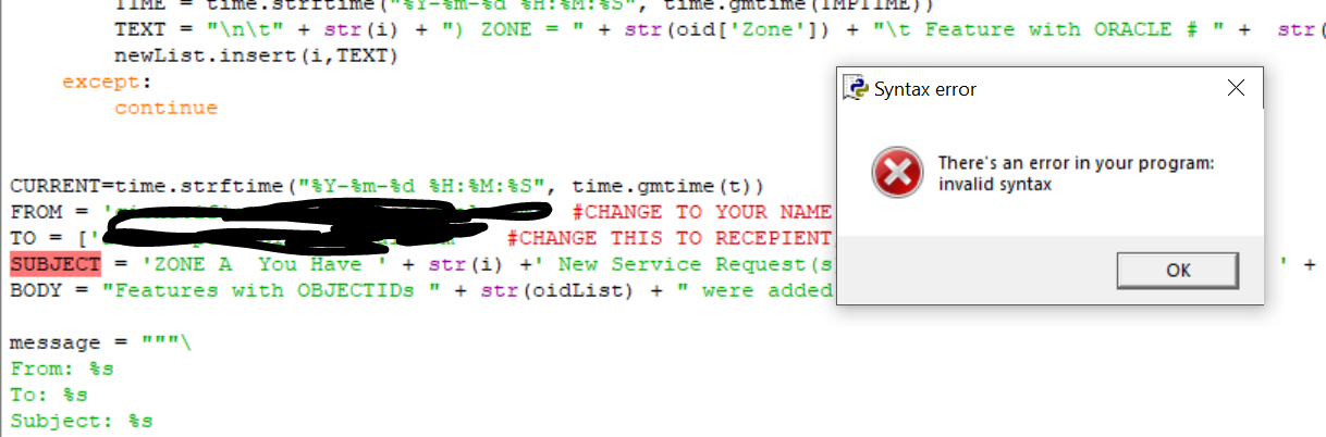

AlexP_
Thank you for the file. I revised it and tried to run it but I got invalid syntax. Screenshot below.
EdwardHankins
Send me the file with your changes and I will look at it.  I am off for the weekend so it wont be till next week.
