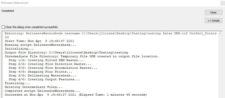

In the image below, you can see no errors are produced by the script and it completes successfully.  Here is an example of me running a simple script from this API which performs the standard workflow to produce watersheds from a DEM raster and a pour points feature class.  The outputs (a watersheds polygon feature class and a pour points feature class) look fine and are created properly.
Tool window.Tool window.

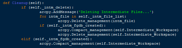

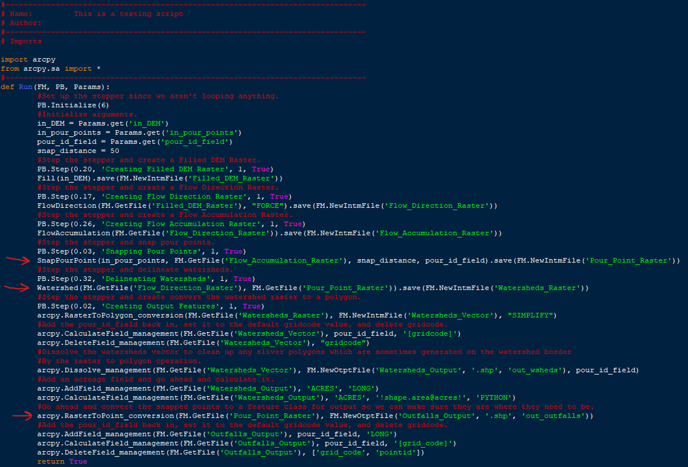

The "remnant" file gdb folder.The "remnant" file gdb folder.Below is the main body of the script.  I have pointed out the lines of code which pertain to the Pour_Points_Raster.  There are no references to this raster dataset after arcpy.RasterToPoint_conversion().
The main body of the script.The main body of the script.The image below shows the bit of the package that runs after the above script has been completed (somewhere around when the output window says "Finalizing..."  Note that the issue is not related to the file name/path not being listed in self._intm_file_list, all "intermediate" files were purged from the file GDB and only the .lock files pertaining to the Pour_Points_Raster remained.  Also note that Compact_management() does not work (and removing this line doesn't fix the problem either).
The portion of the script which is responsible for deleting the file gdb.The portion of the script which is responsible for deleting the file gdb.
