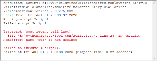

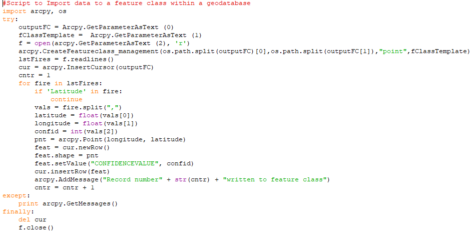

I have Script to create a tool, which converts a comma-delimited text file containing coordinates to a feature class within a database, but an unexpected error appears as in the attached images, is there a workaround for that?
I used ArcMap 10.8 to execute the code!
Please Help...

get rid of the 'finally' section... in fact there is no reason for your code to be in a try-except block, you will get a useful error message without it

In Python, the finally block of code is always executed regardless of what happens above with the try/except.  The problem you are running into is that you have defined a cursor with the try statement, but there is an exception happening before the cursor is defined.  Since the finally block always executes, it is trying to delete an object that doesn't exist, and hence you are seeing a NameError that isn't being caught by your try/except.
In general, you should not be large blocks of code within try statements because it can obscure errors that you may want to pass along to the user.   When using finally statements, don't have an object in them that is defined with the try statement.

It's likely not being created and running your except block.  You can't see the error message because you're using a print statement in a script tool.
arcpy.AddMessage(arcpy.GetMessages())
I would listen to what Dan is saying and get rid of your try/except block until things start working.  You shouldn't throw everything into a script tool straight away until you know the script works, it just makes debugging that much more difficult.

delete the" try" line and the last 3 lines
dedent the intermediate code by one level and run (ie. without the try-except block)
report any error messages that you have
If you aren't running a tool you can use print statements or "tweet" them to cover both scenarios

The code is ready to go after the following fixes:
After checking the script again, I noticed two errors in writing the capital letters and an error in the position of the index number, in addition to the last three lines where I deleted them.
The errors are apparent in the attached photo.
