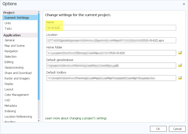

I'm trying to automate exporting multiple layouts from a project. I want all the exported files to share the same name as the project, with an appended string. The problem is I can't find a simple way to extract the project name. I know it's included in the filePath property of the ArcGISProject object, but is there an easier way than having to extract the name from the full path? I know I could use the project name from metadata, but I don't usually fill that out and I'd rather not fill it out simply for this purpose. I really just want to use the name as found in the project settings:
I'm able to use that as dynamic text in the layout; would be great to find it with ArcPy, too.

JeffThomasILM
Thank you, Dan. It looks like extracting the name from the filePath is the only (but easy) way. I was trying to use os.path.join at first, but then I realized it's unnecessary. Essentially the same as your suggestion, I created a variable for filePath with ".aprx" hacked off (without any string splitting; that would be good for isolating the name, but I want the whole string now, eliminating os.path.join). Then in exportToPDF, I called that variable and appended the string I want for the exported file.
I'm using this script interactively, one project at a time. For now, at least, I have no plan to run on multiple projects at once.
