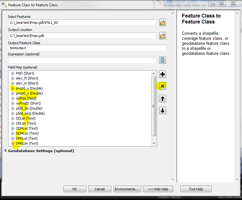

tool, before the delete....will delete all but PtID and the two elev_ fields

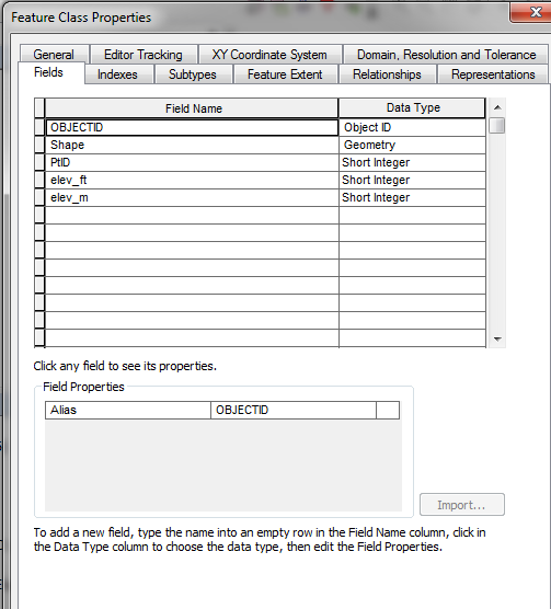

my new featureclass....
