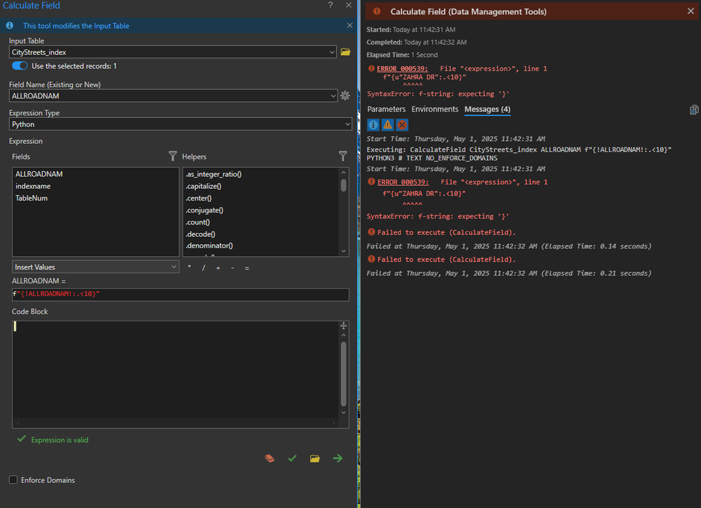

@ClayDonaldsonSWCA Below is what I'm running into with the f-strings. Likely I'm entering it incorrectly, any idea whats going on?
Cheers,
Jon
If this response helps or is the solution to your post, please consider marking it as a solution
AustinAverill
The expression is evaluating your field to include double quotes, and is therefore conflicting with your syntax. Change the code in your field calc to use single quotes instead of the double quotes will resolve the error:  f'{!ALLROADNAM!:.<10}'

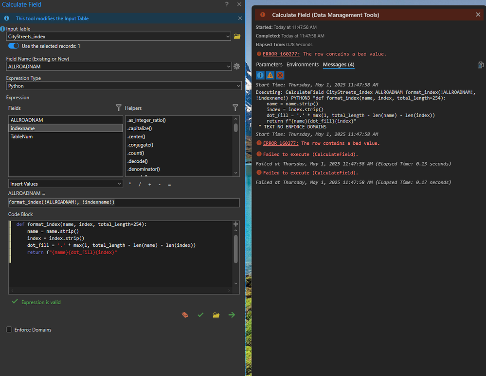

@TonyAlmeida I tried your suggestion and am running into the issue below. Any idea what is going on? I did change the first part before the code block to match my field names.
Cheers,
Jon
TonyAlmeida
MVP Regular Contributor
You probably have nulls, spaces and number and text.

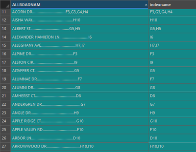

@TonyAlmeida I'm so close! It was able to run in the field calculator - but now I'd like to get dots to even out so the index values are all aligned together. Similar to the first screenshot above. Below is what I have, is there a way to align the index values?
I really appreciate your help!

TonyAlmeida
try,
.ljust(total_length) # this should make sure the output string is exactly 50 characters wide

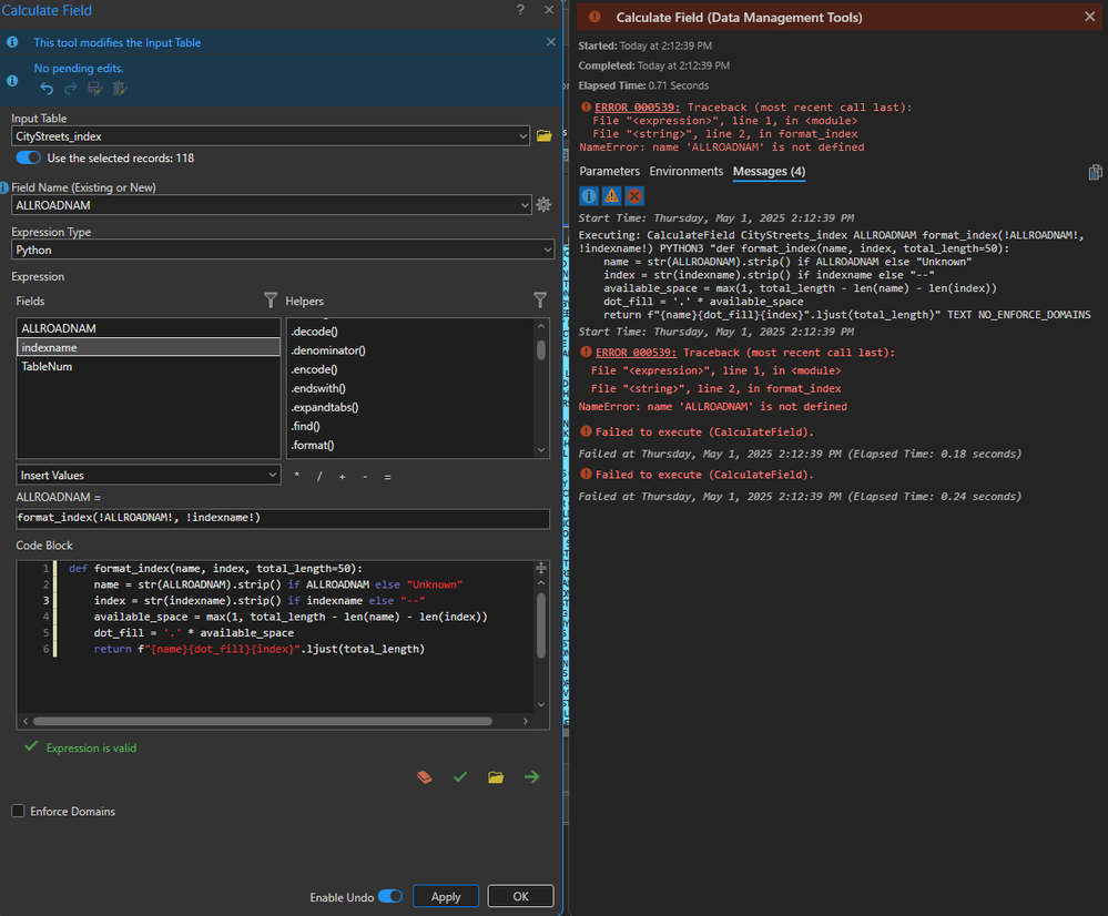

@TonyAlmeida  Unless I entered it incorrectly, I keep having errors pop up when trying to run it.
