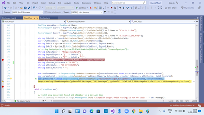

here my complete code for the Geoprocessing tool to run in the dotnet arcpro sdk
await QueuedTask.Run(async () =>
try
MapView mapvView = MapView.Active;
FeatureLayer layer1 = mapvView.Map.GetLayersAsFlattenedList().
OfType<FeatureLayer>().FirstOrDefault(l => l.Name == "ElectricLine");
FeatureLayer layer2 = mapvView.Map.GetLayersAsFlattenedList().
OfType<FeatureLayer>().FirstOrDefault(l => l.Name == "ElectricLine_temp");
string FLPath1 = layer1.GetFeatureClass().GetDatastore().GetPath().AbsolutePath;
var FLPathCombine1 = System.IO.Path.GetFullPath(FLPath1);
string infc1 = System.IO.Path.Combine(FLPathCombine1, layer1.Name);
string infc2 = System.IO.Path.Combine(FLPathCombine1, layer2.Name);
string input1layers = "[" + infc1;
string commainputlayers = ",";
string input2layers = infc2 + "]";
string input4layers = input1layers + commainputlayers + input2layers;
string Outputpoly = System.IO.Path.Combine(FLPathCombine1, "temppolyoutput");
string cluster_tolerance = "";
string attributes = "NO_ATTRIBUTES";
string label_features = "";
var environments1 = Geoprocessing.MakeEnvironmentArray(overwriteoutput: true);
var parameters1 = Geoprocessing.MakeValueArray(input4layers, Outputpoly, cluster_tolerance, attributes, label_features);
var gpResult1 = await Geoprocessing.ExecuteToolAsync("FeatureToPolygon_management", parameters1, environments1);
Geoprocessing.ShowMessageBox(gpResult1.Messages, "GP Messages", gpResult1.IsFailed ? GPMessageBoxStyle.Error : GPMessageBoxStyle.Error);
catch (Exception exc)
// Catch any exception found and display in a message box
ArcGIS.Desktop.Framework.Dialogs.MessageBox.Show("Exception caught while trying to run GP tool: " + exc.Message);
return;
it will be great if you help me , thanks in advance

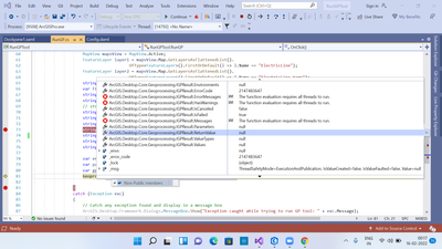

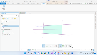

i got the output with same code running no issues  one layer-, thank you can we run for both layers as mentioned below in the python code which is running for both layers
ElectricLine_Temp = "C:\\Users\\anile\\OneDrive\\Desktop\\ANIL_INVANTGE\\1.DATA\\working_DB\\Test.gdb\\ElectricLine_Temp"
ElectricLine = "C:\\Users\\anile\\OneDrive\\Desktop\\ANIL_INVANTGE\\1.DATA\\working_DB\\Test.gdb\\ElectricLine"
# Process: Feature To Polygon (Feature To Polygon) (management)
polytemp123 = "C:\\Users\\anile\\OneDrive\\Desktop\\ANIL_INVANTGE\\1.DATA\\working_DB\\Test.gdb\\polytemp14"
arcpy.management.FeatureToPolygon(in_features=[ElectricLine_Temp, ElectricLine], out_feature_class=polytemp123, cluster_tolerance="", attributes="ATTRIBUTES", label_features="")
in  string input4layers = input1layers + commainputlayers + input2layers;
value is  [ElectricLine_Temp, ElectricLine]
please kindly help me
