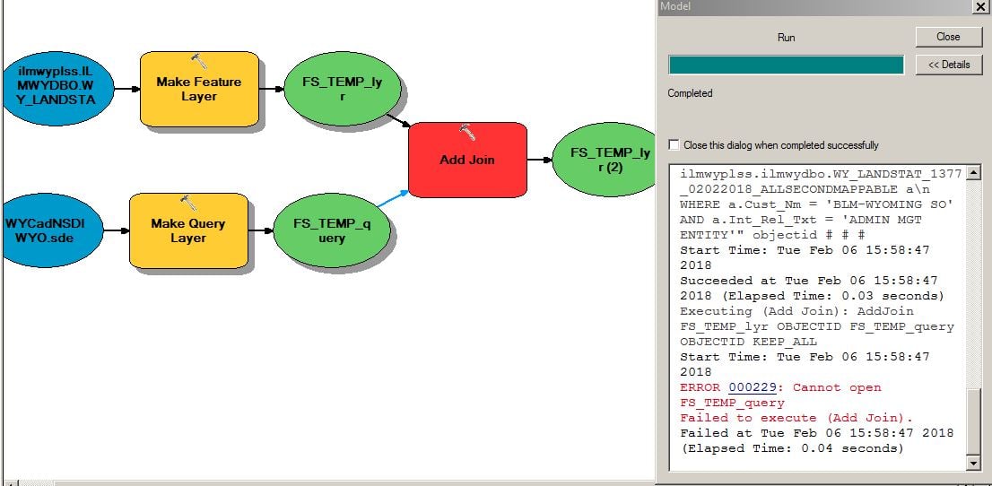

I have a series of Query Layers that I can create manually no problem and join back to a feature layer, but when I try to perform the process in model builder or a python script I get: ERROR 000229: Cannot open <query layer>. The query I'm testing is really simple, so I'm pretty sure the error isn't with the query, but I have several more complex queries to process. AddJoin fails because it can't locate the query layer, and it really doesn't matter what tool you use next to process the query layer (Table to Table, Append,...) they all fail with the same error. I can add the query layer to the display, it is fine, but model builder/python can't locate for the iteration of the next tool.

Error: 000229: Cannot open
• The data is inaccessible, unavailable, or invalid.
• There are unsupported data types in 64-bit background processing.
• Unsupported tools are unable to run in background processing.
• The 64-bit background geoprocessing does not have the necessary 64-bit libraries.

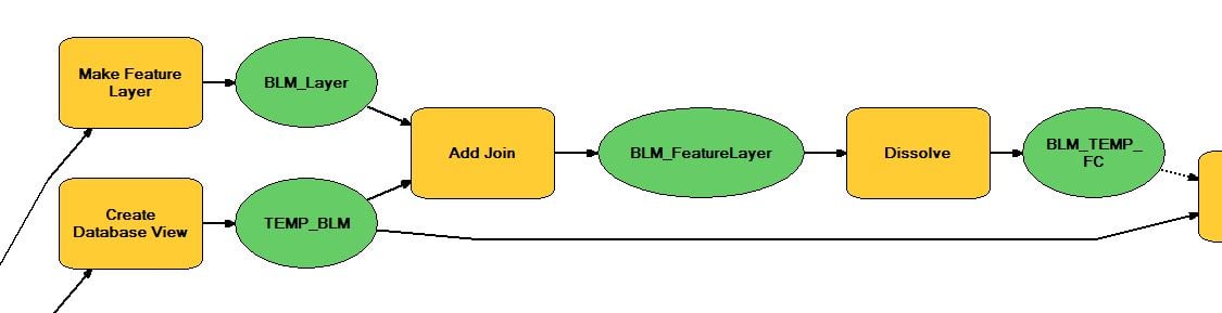

I did find a work around using database views.
