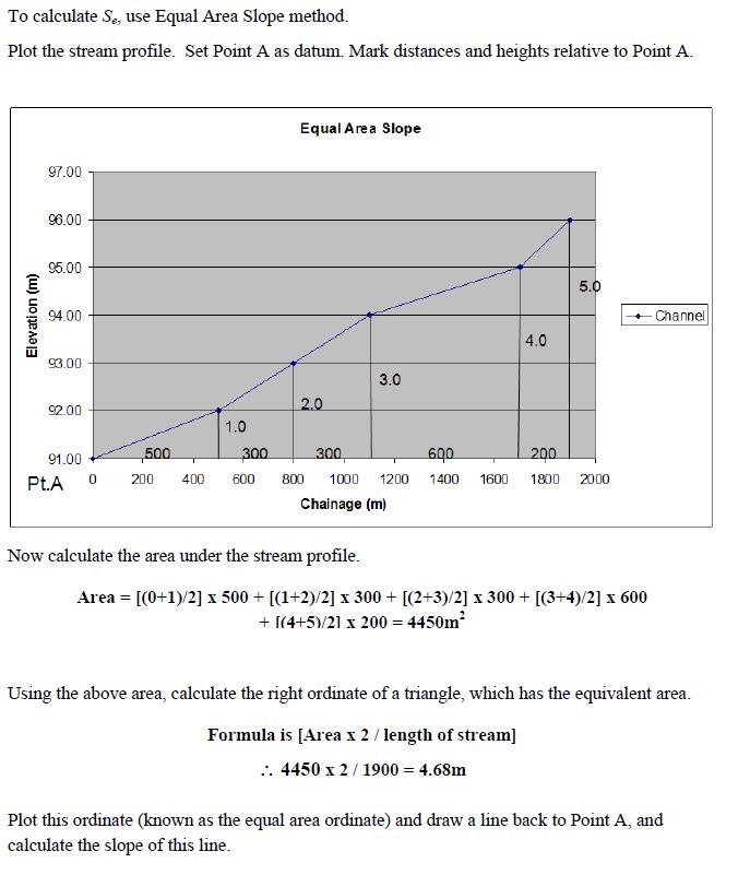

I'm currently busy writing a Python Module to determine the Equal-Area Slope of the Longest Flowpath of each catchment. I need to generate a Python Dictionary for each Longest Flowpath within the polyline Feature Class with the following format.
v = vertex
z  = Change in height (i.e. 0, 1, 2,....150)
seq = segment length between vertices (i.e. v1 - v2, 200m, v2 - v3, 300m,....v100 - v101, 500m)
longestflowpath_dict = {DrainID: [(v1(Z), v2(Z), seg1(M)),(v2(Z), v3(Z), seg2(M)),...(v100(Z), v101(Z), seq100(M))
What  approaches could I use to extract the geometry Z and M between each vertices to determine the lengths between each vertices. The Z values stored are the accumulated difference in height between each vertices.
I've included the documentation from the engineering manual with the manual methodology of determining the Equal Area Slope.

Thanks for the following. In order to get the following solved before my deadline. I extracted the Z values from the DTM using the InterpolateShape_3d. I then split the polylines using SplitLine_management to split the polyline in segments. I added the the following fields: ["STElev", "EndElev", "STElevation", "EndElevation"]. I then calculated the Start Elevation and End Elevation using Calculate Geometry.
Thereafter  I calculated the "STElevation" by subtracting each elevation by the initial STElev (i.e. 355.9268 - 355.8495), "EndElevation" (i.e. 355.6268 - 355.9268). I then used a Search Cursor and calculated the area for each trapezoid using the following formula:
