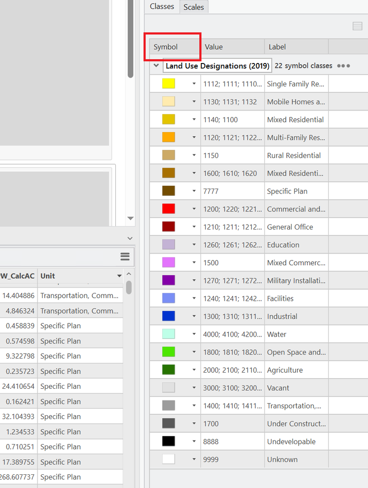

Hi,
I am a GIS Analyst/Urban Planner working with land use data. I have a standard land use symbology for use in different cities and counties.
I am trying to extract the hex codes from the layer symbology and add them as a new field. The script from this solution post by @JohannesLindner . The script works to add the label of my symbology layer to a new field:

I am curious how I would add the hex codes into this code to add a new field that would include the six-digit hex codes; RGB codes work too. Thanks for any help. I am new to arcpy and will be attending the Developer Conference in two months.

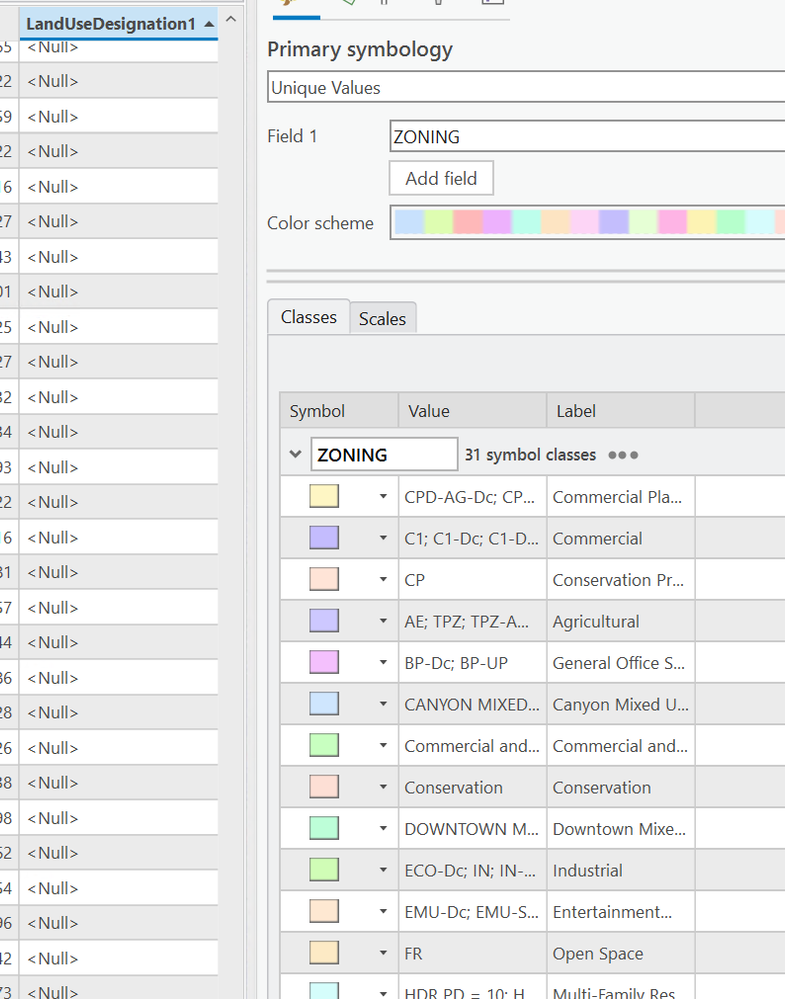

ChrisGiamarino
whoa! thank you so much @JohannesLindner
one last quick question...when I run the initial code on Grouped Values, it only searches for the first value in the group and applies the new Label. See screenshot...how can I get the initial code to search through each land use code after the semi-colon and add the new label?
sample code again:

ChrisGiamarino
epic! thank you. I am familiar with geopandas and folium. arcpy is new to me. I appreciate your explanations and comments (#)

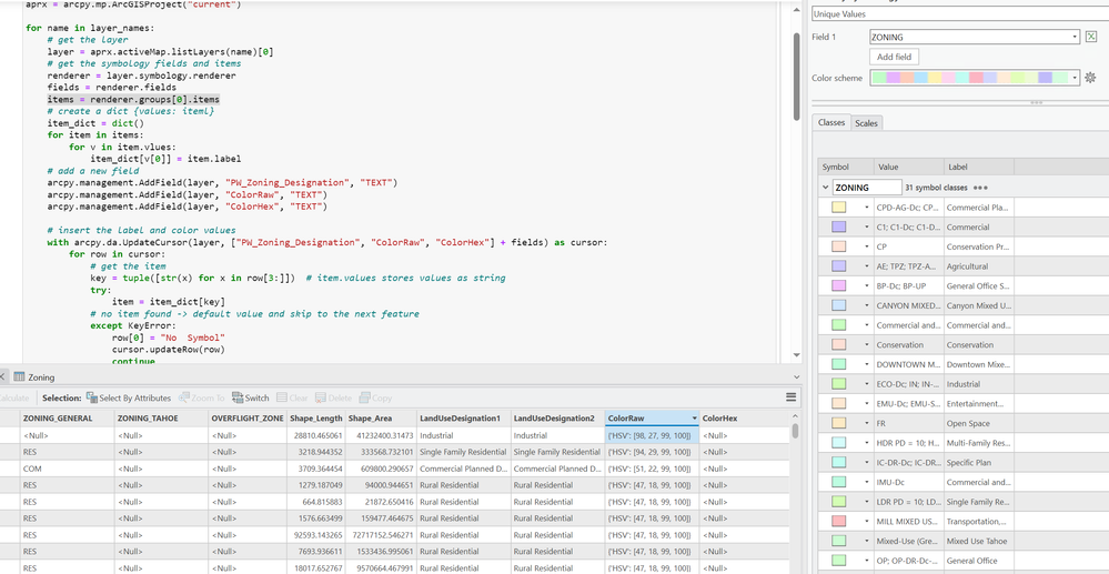

ChrisGiamarino
@JohannesLindner
here is my sample code trying to iterate through groups and apply color column value attributes. I am getting an index error saying 'IndexError: list index out of range'
layer_names = ["ZoningPlacerCo"]
aprx = arcpy.mp.ArcGISProject("current")
for name in layer_names:
    # get the layer
    layer = aprx.activeMap.listLayers(name)[0]
    # get the symbology fields and items
    renderer = layer.symbology.renderer
    fields = renderer.fields
    items = renderer.groups[0].items
    # create a dict {values: iteml}
    item_dict = dict()
    for item in items:
        for v in item.vlues:
            item_dict[v[0]] = item.label
    # add a new field
    arcpy.management.AddField(layer, "PW_Zoning_Designation", "TEXT")
    arcpy.management.AddField(layer, "ColorRaw", "TEXT")
    arcpy.management.AddField(layer, "ColorHex", "TEXT")
    # insert the label and color values
    with arcpy.da.UpdateCursor(layer, ["PW_Zoning_Designation", "ColorRaw", "ColorHex"] + fields) as cursor:
        for row in cursor:
            # get the item
            key = tuple([str(x) for x in row[3:]])  # item.values stores values as string
            try:
                item = item_dict[key]
            # no item found -> default value and skip to the next feature
            except KeyError:
                row[0] = "No  Symbol"
                cursor.updateRow(row)
                continue
            # store the item's label
            row[0] = item.label
            # get the symbol color
            color = item.symbol.color
            color_type = list(color.keys())[0]
            # if it's rgb, convert to hex
            if color_type == "RGB":
                rgb = color["RGB"][:3]
                row[2] = '#%02x%02x%02x' % tuple(rgb)
            # if it's something else (hsv, hsl, cmyk), you have to convert that in other ways... here I just don't convert
            else:
                row[2] = None
            # store the color value as string for documentation
            row[1] = str(color)
            # write values
 the error is on line ten: items = renderer.groups[0].items

layer_names = ["TestPolygons"]
    # get the layer
    # create a dict {values: item}
    item_dict = get_item_dict(layer.symbology)
    # add a new field
    with arcpy.da.UpdateCursor(layer, ["PW_Zoning_Designation", "ColorRaw", "ColorHex"] + layer.symbology.renderer.fields) as cursor:
        for row in cursor:
            # get the item
            try:
            except KeyError:
                continue
            row[0] = item.label
            # store the raw color
            row[1] = str(item.symbol.color)
            # store the hex value
            row[2] = convert_to_hex(item.symbol.color)
            # write values
