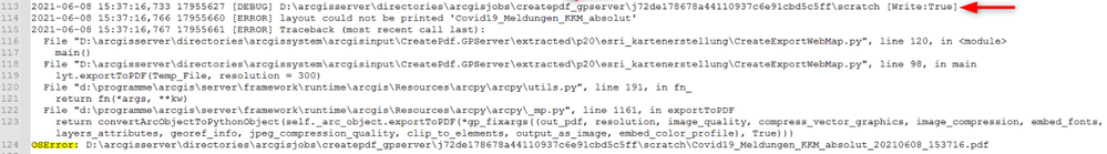

The idea is to provide a GPService which takes a public WebMap, uses a predefined ArcGIS Pro Project (.aprx) also published with the GPService, reading a layout and printing this layout as pdf document.
In my tests on my machine and three different ArcGIS servers, this has been no problem. Also running on the customers ArcGIS Pro client worked as expected, but when rolling out on the customers server, we always get an OSError when executing the ExportToPDF method.
What we already verified/tested:
  • different file directories: hard coded temp folder or the scratch folder from arcgis
  • shortened the file and directory names
  • tripple checked write permissions, we have
  • used different users, even full previliged from their IT department
  • executed the script via GPService or via python shell, both results in the same OSError
  • tested with ExportToJPG and ExportToPNG, both also produces the same error
  • tested, if a PDF program is necessary (it is not)
  • tested, if a PDF in general could be produced with python (is possible)

MaximilianGlas
Hi Sam,
it seems that we could locate the reason for our problem.
There were some texts in our layout that were apparently responsible for the problem. When we removed the texts, printing worked without any problems.
We have found a patch that should fix the problem. Initial tests are promising.
ArcGIS Server 10.8.1 Print Service and Text Element Patch
Maybe this will work for you too.
