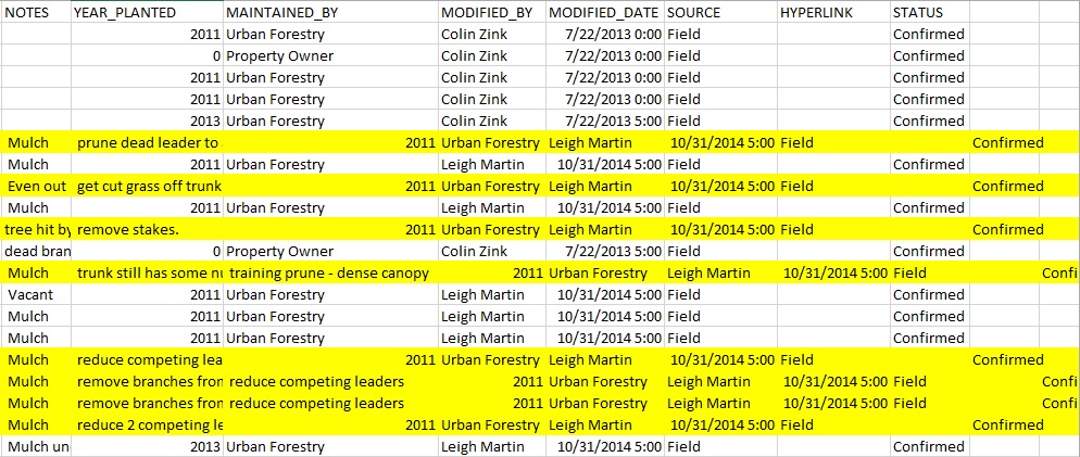

I have a python script tool that exports records from a feature layer using an (area of interest - aoi).  The tool works well, but the problem is that if I have a comma in text in one of the field records, it will break the text after the comma and move it to the next field.  The shown below that are highlighted in yellow show records that are offset.
I am attaching the toolbox along with the script.  Is there a way I can fix this issue?  I didn't get any help from ESRI.  They just forwarded me some links, but I figure I can get some assistance from here.

Well, that is the format for csv files. You could do some fancy checking and replacing. It looks like from your example that the first intended field is the problem one. You could check if the next value is a year, and if not, replace the comma with a zero length string. That could be prone to error, and you may have the same problem in other fields anyway.
It might be easier to make it a tab delimited or fixed length file. That's what I'd look at, anyway.

you could use the python csv library to create the file.
13.1. csv — CSV File Reading and Writing — Python 2.7.8 documentation
using a search cursor to format your data appropriately.

I think the problem with that would be in the formatting of data. There are potentially ‌n‌ number of commas in ‌n‌ number of fields. Not to say it couldn't be done, but it wouldn't be a very efficient process.

If it were me I would fix the datasource first.  I could understand a comment field that I *MIGHT* allow commas into it, but probably not because it leads to situations you are in now.  So fix the thing that is creating the .csv datasource so that it doesn't allow commas to be inserted.  That'd be the optimal thing to do.
If not an option then I'd have a separate process that ran to removes commas and convert them into tabs instead.  You will still have to do a bunch of gymnastics to find the specific scenario(s) that you want to use to do the replace.
...which is why it's best to juts fix the source data.
This is where I'd focus my first effort.  When it's a Feature Class (before you run your tool), remove any commas in any of the fields.  But again, why are you letting them into the data in the first place?  Control that process and you don't need to deal with this problem.

I agree with @Dallas Shearer.  You can use the Python csv library.
The CSV format allows for escaping special characters, so you can have commas in a field.  You would quote that field, as in:
field 1, "This, field has, commas", Field 3
There is a way to handle fields containing quotes as well.  It gets a little messy if you have an assortment of such punctuation, but the csv library handles it for you.
Here's a couple of links:
Writing Escape Characters to a Csv File in Python - Stack Overflow
java - How to escape comma and double quote at same time for CSV file? - Stack Overflow
One of the contributors to one of those threads also had a good suggestion:  If you want your CSV to be compatible with Excel, take one of those strings, copy it into Excel and save it out as CSV.  Then you will know how Excel wants it formatted.

In similar situations in the past, I just resorted to using the pipe symbol or vertical bar as the field separator.  Although I have seen crazy data where people use commas, colons, semicolons, and slashes in places they shouldn't be; I seldom run across people using vertical bars in free-form text.
