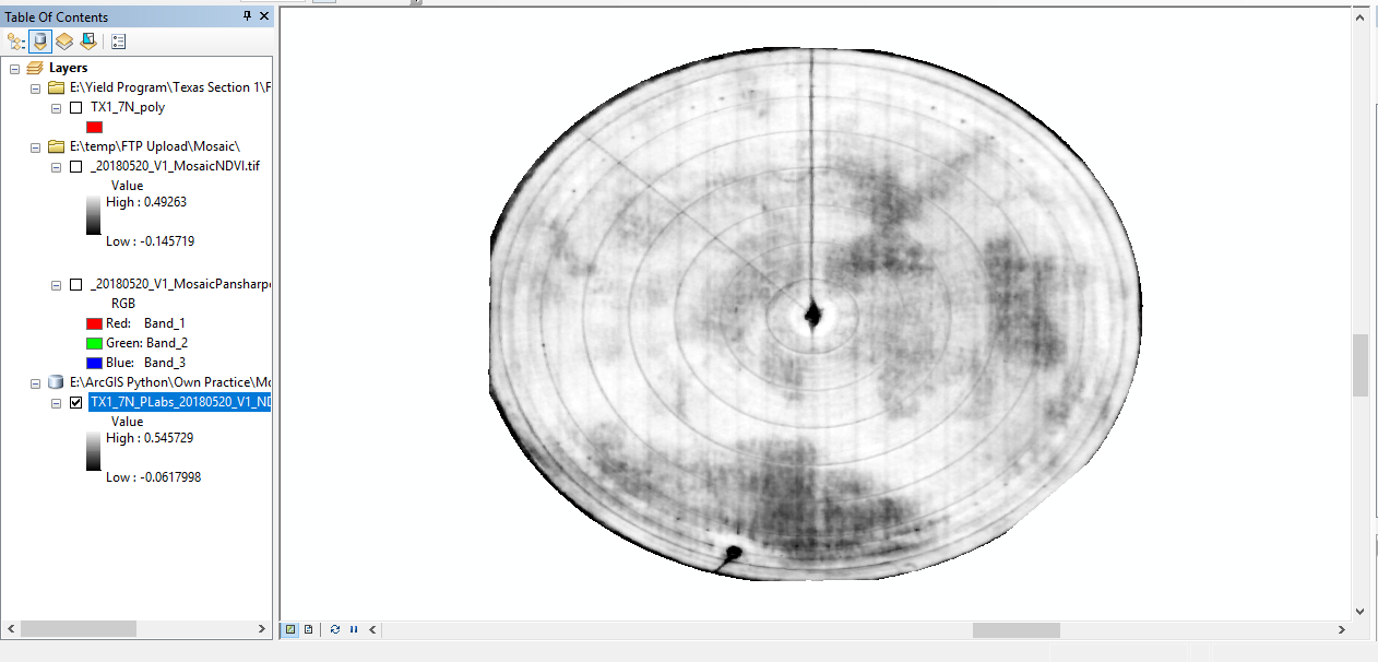

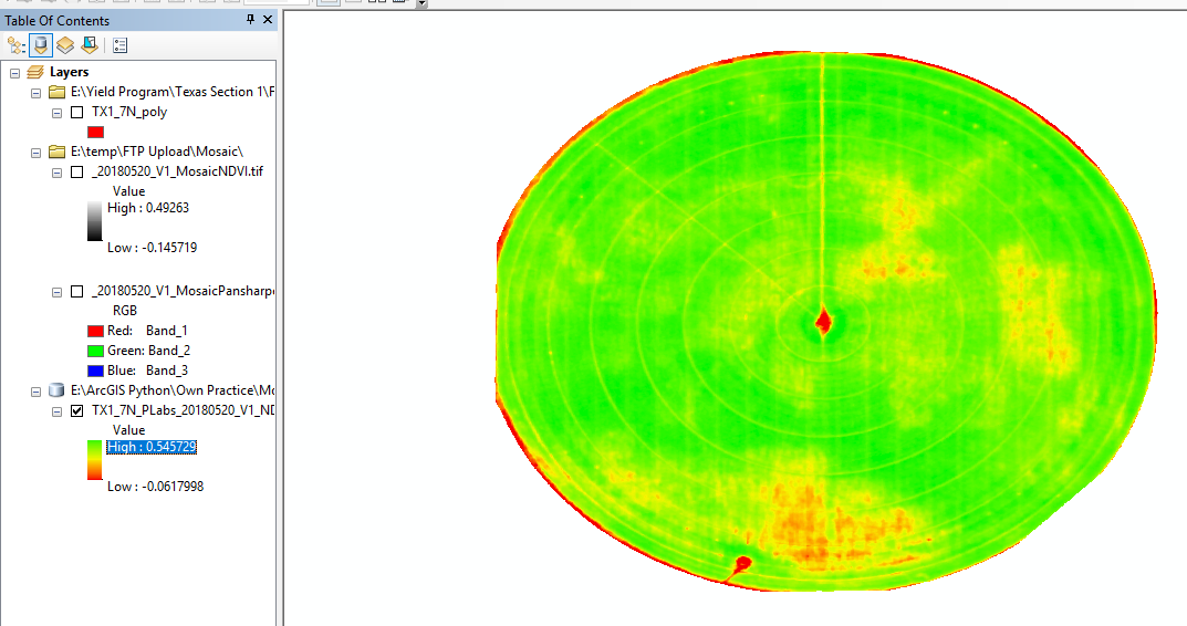

I am trying to explain the whole scenario -
1. The shown image is the pansharpened image which contains 4 bands (BGR and NIR)
2. NDVI was generated using "Image Analysis" option. The object of interest is the field no. 7N as its shapefile is also turned on (red circle.)
3. Here is the clipped field -using "Extracted By Mask" (Spatial Analyst) tools.
4. After changing the color ramp, is it looks like this. It is better for visualization, so our team asked for the same color image. I am trying to save this file with exactly this color. If I use copy raster then the result gets back to the image shown in no. 3 (grayscale).
Can you please tell me is there really anyway to save the raster exactly the same [as shown in no.4] with Python (Export function can do that)?
