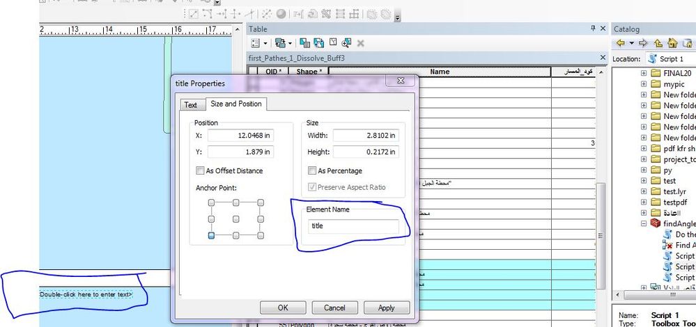

MahmoudHegazy
i made test and change  the lebel to "title" as you see in the screen shot but the pdf exportefd without chang
e the dynamic lebel can you retest the code and see it again

DavidPike
MVP Notable Contributor
ah I think I made a silly error, I'm unable to test this.
side note - why are you using mxd.save() and why have you got outFile variable created then overwritten 2 lines later?

MahmoudHegazy
the code worked
