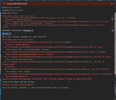

shildebrand
Thanks Jake!  Do you know how to reference the a feature class field that has the URL in it?  The script below returns an error showing that the "LINK" field is an invalid URL.  I'm guessing I probably have an incorrect syntax?
import arcpy
import os
import requests
fc = arcpy.GetParameterAsText(0)
dest_path = arcpy.GetParameterAsText(1)
print(fc)
cursor = arcpy.SearchCursor(fc)
for row in cursor:
    #url format = http://wapgis61/Scans/101-005/101-005.pdf
    url = "LINK"
    print ("Downloading: " + url)
    response = requests.get(url)
    with open(dest_path, 'wb') as f:
        f.write(response.content)
print("Download Complete")
JakeSkinner
Esri Esteemed Contributor
Try the following:
import arcpy
import os
import requests
print(fc)
with arcpy.da.SearchCursor(fc, ['LINK']) as cursor:
    for row in cursor:
        print("Downloading: " + row[0])
        response = requests.get(row[0])
        outputFile = row[0].split("/")[0]
        with open(dest_path + '\\' + outputFile, 'wb') as f:
del cursor
shildebrand
Thanks Jake, with a slight modification to your suggestion, it worked!  Just changed the index number to 5 in row 13.  Thanks for your help!
import arcpy
import os
import requests
print(fc)
    for row in cursor:
        outputFile = row[0].split("/")[5]
        print(outputFile)
            print(f)
del cursor
