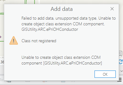

DN_GIS_Analyst
Because of the screenshot below:
DN_GIS_Analyst
I don't encounter the problem like shown in the screenshot if I do this directly from ArcMap or ArcCatalog.

JakeSkinner
Esri Esteemed Contributor
@DN_GIS_Analyst it looks like your Enterprise Geodatabase is using ArcFM?  Or, possibly some other customization that is not supported in ArcGIS Pro.  I would recommend copying all data to a File Geodatabase via ArcMap, and then paste into a new Enterprise Geodatabase.
DN_GIS_Analyst
I discovered that ArcMap uses ArcFM objects, so in order to use them, ArcFM Convertor tool is needed to convert them into ESRI objects. I didn't know about this until I had a conversation with someone from IT GIS team. Fortunately, they already had made conversion a part of their QA process but never communicated that to me until I talked about my trouble. So, it's been resolved.
