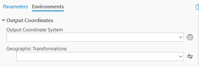

I build a new geoprocessing tool, and I want to set a default outputCoordinateSystem in Environment:

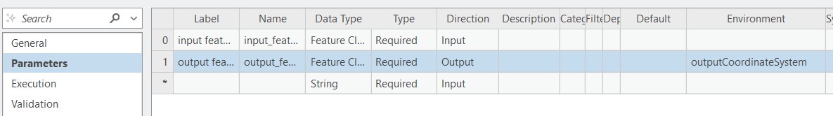

I found we have it tool parameters:

Your parameter name is the Name field. that is not 'outputCoordinateSystem' in your screenshot, but 'output_feature...'

EugeneSosnin_GSI
Thank you for the answer.
Yeah, I am still confused how to set the Environment parameter. Therefore, I could not accept the answer.
