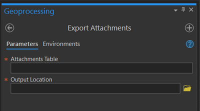

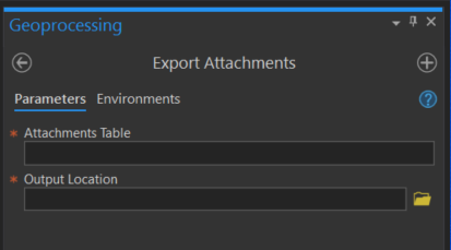

EDIT: I just realized that the input and output just indices to the inputs in the tool. Here's what the tool looks like. Running a script like above without putting anything into the tool won't work...unless I hardcode the parameters (having trouble with that too!).
