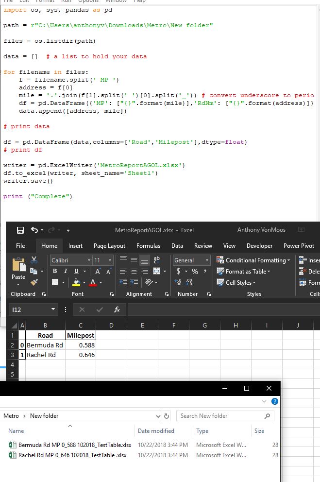

I'm trying to pull cell values from the files I'm grabbing in the code below so I can write them in the loop for a new column. The column will be called ADT and their value is in cell A333.

what does it do now?
by Anonymous User
Not applicable
It's pulling values from the filename and adding it to an excel table. I'm now wanting to pull cell data from within each file and add it to the excel table it is creating.

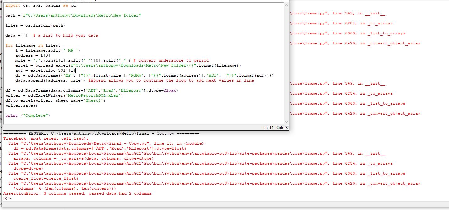

I made the change mentioned above and am receiving the error below.
DarrenWiens2
MVP Alum
You do a bunch of work to get things into the dataframe within the loop, but never use it. Rather, you append to 'data' (2 columns), and then attempt to make a new dataframe from that (specifying 3 columns).
I assume you should use:
data.append([adt, address, mile])
by Anonymous User
Not applicable
Thanks for you help!
