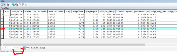

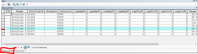

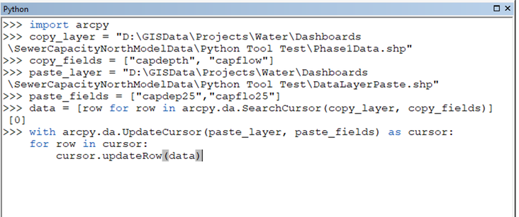

Johannes I documented all the steps that I am using with the first script to show the results to so that you can better understand what I was trying to describe as the problem.
Step 1:
Select 1 row from each table
Step 2 run the script:

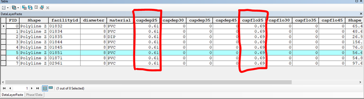

Here’s what the result looks like in the table that the data was pasted to:
The data is not pasted to just one record it's pasted to all of them, which means that if I ran the tool a second time for a new segment it would just overwrite all the data from the first run.
I hope that helps explain the problem I was trying to describe.
