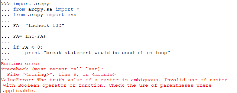

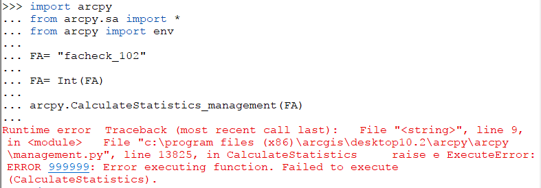

A program that I created has a loop that runs and it constantly lowers the values of a flow accumulation Raster. There gets to a point where the Raster should hit the value zero or no data. The raster comes out with a positive big number and a negative big number, which messes up the calculate statistics function in the loop. Here it is below.
This is an example of the error I would receive
Is there a way I can create an if statement in the loop to check for a raster that looks like this and break away from the loop? Something like this but a statement that would work.

You can also use Get Raster Properties—Help | ArcGIS Desktop with the "ALLNODATA" option to test for it.
Example:
fa = r'C:\GeoNet\TestNull\myras.tif'
test = arcpy.GetRasterProperties_management(fa, "ALLNODATA")
test = int(test.getOutput(0))
if test == 1:
    print "Raster contains all NoData pixels..."
else:
    print "Not all pixels are NoData..."

I assume that you are running this in the Python Window inside a session of ArcMap and the raster is present in the TOC. Otherwise, I guess you wouldn't find a raster only by its name.
You could use a try except to catch any errors:
import arcpy
fa = "facheck_102"
try:
    fa = arcpy.sa.Int(fa)
    arcpy.CalculateStatistics_management(fa)
except Exception as e:
    print "ERR:", e
