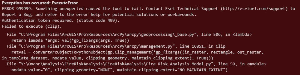

When I run the code, I am receiving "Authentication token required" error message. I tried to rewrite the code to pass in the portal item but I am still getting the same error message.

Error Message :
Authentication Token Required Error Message
