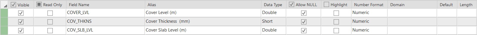

In ArcGIS Pro I have a feature class called SWNDMNHL which has the list of fields, in which some fields have empty length, but when I'm fetching this fields from Python arcpy library it gives me a random field length instead of empty field length. How should i validate the field length?
for fld in arcpy.ListFields('SWNDMNHL'):
   print(f'Field : {str(fld.name)} and Length : {str(fld.length)} ')
It gives me below output:
Field : COVER_LVL and Length : 8, Field : COV_SLB_LVL and Length : 8, Field : COV_THKNS and Length : 2
Any suggestions?

Using ArcPy Module I'm getting the Length of Field using ListFields() Method, as you can see in screenshot Field Length is Empty but I'm not getting empty length, For Short getting 2 as Field Length and for Double getting 4 as Field Length instead of this, I want Empty Fields to Validate!

The two lengths you are looking at are not measuring the same "length."  Although Esri doesn't clearly state it, the behavior you are seeing can be explained by the Fields view in the ArcGIS Pro GUI displaying FieldDescription Class—ArcGIS Pro length while the ArcPy Field object is giving you Field Class—ArcGIS Pro length.  The FieldDescription Class length only applies to String and OID fields, so it shows nothing/empty for numeric data types, while the Field Class length applies to all fields.

I want the Fields which doesn't have length but with ListFields() I'm getting default value like for instance if the Field type is Short then it will return Field Length 2 but as you can see in provided Screenshot, I do not assign any Field Length to that attribute.
