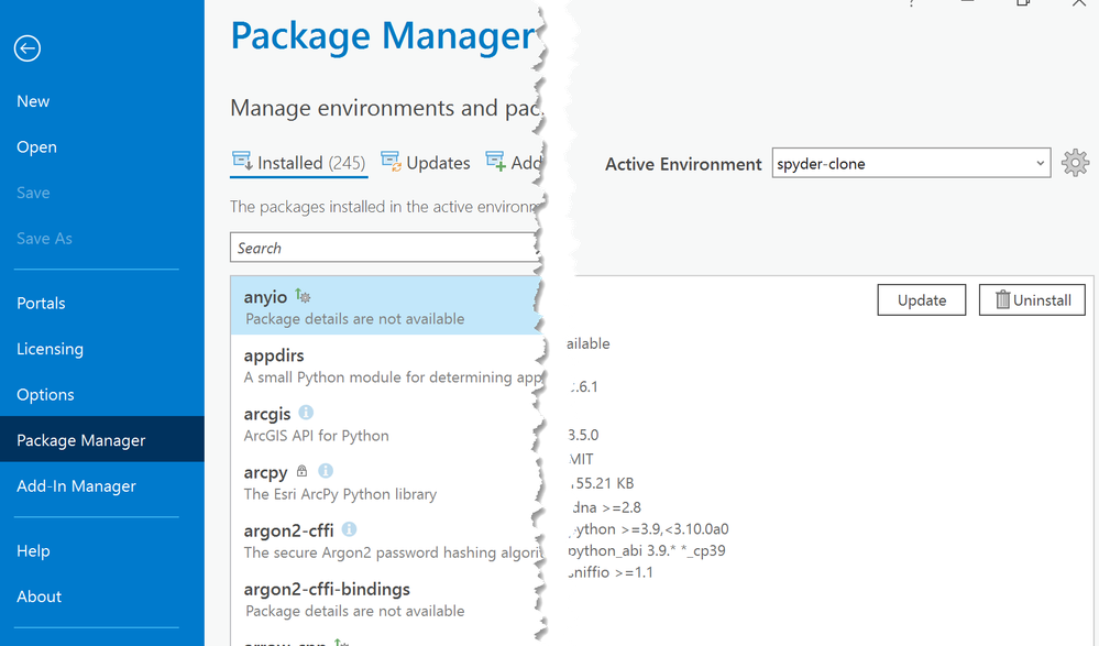

one way or the either (eg through conda or through Pro) you should activate the environment that you want to use
Project backstage, Package manager, then activate the environment you want use

Adding to what Dan wrote, when you set an environment as the default for Pro by activating it, the shortcuts including the ones for IDLE in the explorer menu are rewritten to point at the custom environment being used. This way, the IDE and Pro are kept in sync, which is what most folks typically want.
