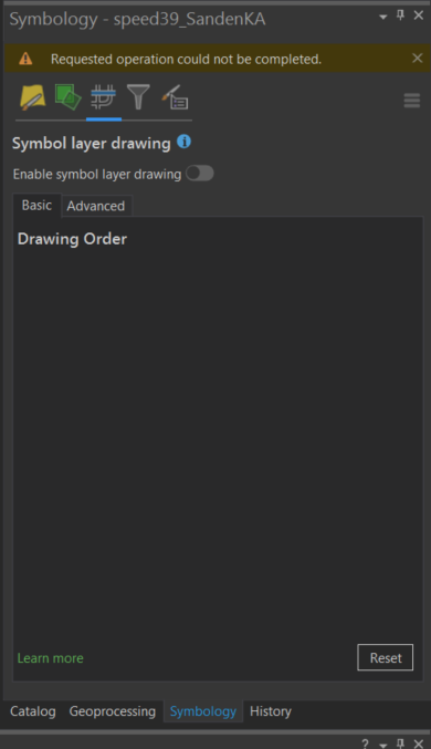

However, when running this the drawing order seemingly does not change. The symbol layer drawing button in the symbology is not enabled and the symbol layers are no longer listed in the symbology. Instead, a warning appears "Requested operation could not be completed" :
