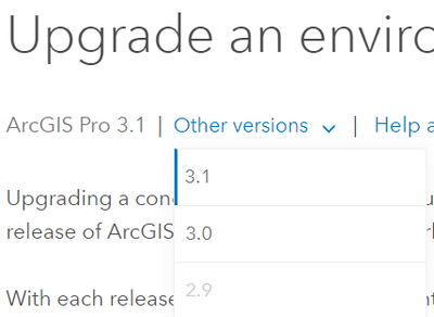

did you try updating the environment?
Don't know about 2.9, but in 3.x
Upgrade an environment—ArcGIS Pro | Documentation
check your version of the help topic

Trippetoe
Nope - not yet anyway. I'll do that right away. Thank you for the link.

Trippetoe
Turns out that updating the environment with a magic desktop command is not possible in 2.9, and the
conda proup
command doesn't exist yet.  Any other ideas i can try other than just rebuilding the environment from scratch?
