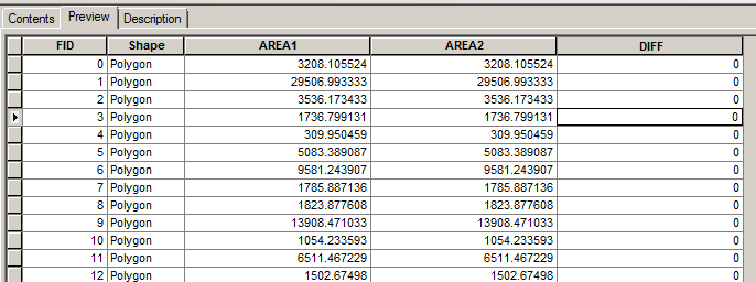

I am running ArcMap 10.4 on Windows 7 x64 Enterprise Edition.
When I preview your shapefile in ArcCatalog, I don't see any differences at all:
DanPatterson_Retired
MVP Emeritus
No errors... your problem is a display issue, your geometry is correct.

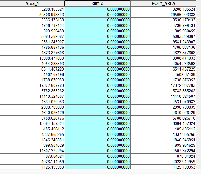

As you can see on the following screanshot there errors and they are visible and countable.
Also if you try to Select by attributes with AREA1 <> AREA2, all polygons are selected.
And with ArcCatalog, on the view of the table, it uses the default size for decimals (6 digits), that's why you see only zeros.
As you can see there are a few polygons that have 0,000000000 as difference. I assume that the difference is even smaller (probably 0,0000000001). If you change the number format of the DIFF field in scientific, you will see the exact difference, as follows:
